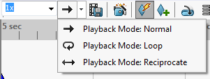

About Playback Modes The motion study playback mode determines whether the motion simulation runs once, repeats, or loops continuously forward and backward. You can run three playback modes in a motion study: Normal , for playing the motion simulation once Loop , for continuously repeating the motion simulation from start to finish Reciprocate , for playing the motion simulation forward to the end, and reversing the motion back to the start in a continuous loop. You can access the playback mode list from the MotionManager toolbar, to the left of the Save Animation tool.
