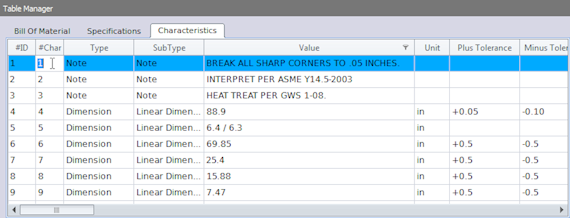

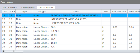

You can renumber characteristics in the Bill of
Characteristics and include gaps.
To renumber characteristics, on the
Characteristics tab, double-click the Characteristics Number field
#Char) and type the new number. All subsequent
characteristics are renumbered accordingly.
