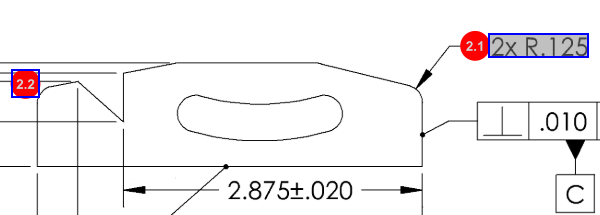

When a characteristic
refers to multiple instances of a feature, you can add multiple balloons to the drawing to
identify each instance.
For example, this radius refers
to two fillets:
![](keh1497986314584.image)
To add multiple balloons:
In the Table Manager:
Create a line for each instance.
Right-click an instance and click Create and Place Sub
balloons.
Click anywhere in the document to place additional balloons.
In this example, you add balloon
2.2. Balloon
2 automatically changes to
2.1.
