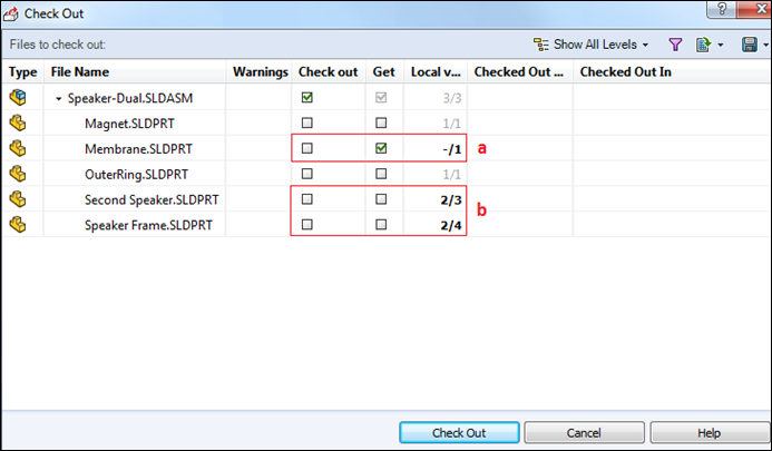

- Under Check out and version access controls, do one of the following:
- Clear Auto select reference files to get latest
when checking out.
This option is selected
by default.

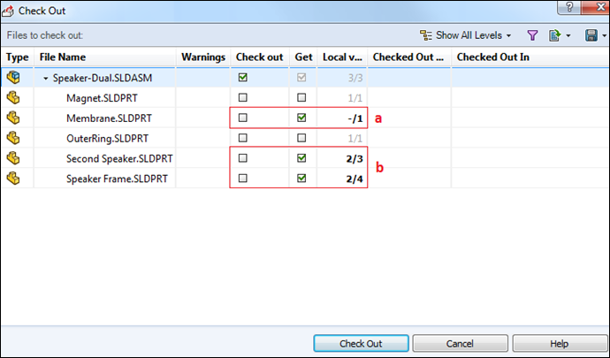

The following screen capture shows the
check boxes in the Get column
when users issue the Check Out
command with Auto select reference files to
get latest when checking out cleared.
Get is selected for references
that are not in the local cache.
Get is cleared when older
versions of files exist in the local cache.
Users
can modify the selections in the Get column before completing the checkout. If users do
not modify the settings, the software retrieves the latest version of
references that are not cached and does not update the references that
are cached.

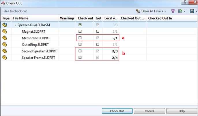

- Select Auto select reference files to get latest
when checking out.
capture shows the check boxes in the Get column when users issue the Check Out command with Auto select reference files to get latest when
checking out selected.
Get is selected when older
when checking out and Always work
with latest version of files.
Always work with latest version of
files was previously available on the Explorer tab of the Settings dialog box, under Miscellaneous.
The following screen capture shows the check boxes in the Get column when users issue the
latest when checking out and Always work with latest version of files
selected.
Users
cannot modify the selections in the Get column. The software automatically retrieves the
latest version of all references if the latest version is not in the
local cache.
