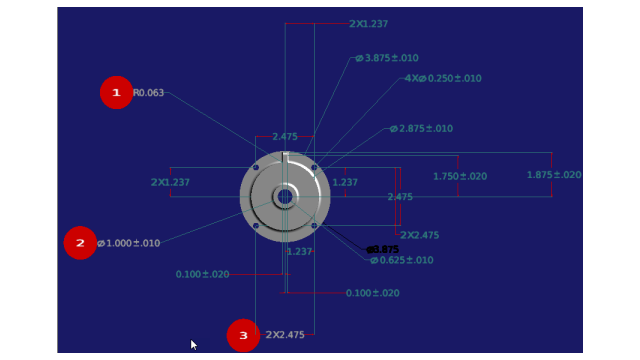

You can open SOLIDWORKS parts with 3D annotations in SOLIDWORKS Inspection Standalone to create inspection documents.
You can:
  • View SOLIDWORKS parts with 3D annotations.
  • Use 3D CAD data to quickly create First Article Inspection (FAI) reports.
  • Read and extract 3D annotations to build reports using Smart Extract.
  • Add quality control to your drawingless manufacturing strategy.
