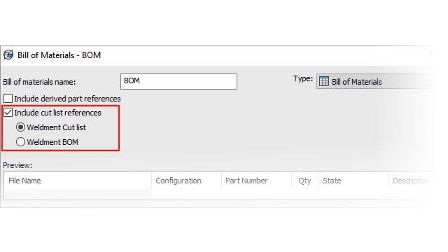

You can configure a computed BOM to include cut list references
and then export it to an XML file.
In the Administration tool, in the
Bill of Materials dialog box, select Include cut list references. You can base the cut list
references
on
the Weldment cut list or the Weldment BOM.
If a cut list item is defined as Exclude from
cut list in SOLIDWORKS, it is not displayed in the computed BOM.
