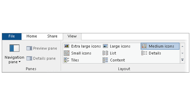

The ribbon control of Microsoft®
Windows® File Explorer is also available in
SOLIDWORKS PDM File Explorer.
Currently, in SOLIDWORKS PDM File Explorer, only View commands
and few other commands of the ribbon control are supported.

- The file list and the search result lists support all Windows
File Explorer view types except for Content.
