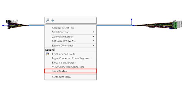

Locking Route Segments You can lock a route segment to preserve its properties when you update or modify other routes. Right-click the route and select Lock Routes. Parent topicRouting Routing Multiple Wires Through Clips Location of Tables in Flattened Routes Table Properties in Flattened Routes Selecting Several Routes for Electrical Attributes Keeping Cable Ends at Correct Pin Locations Hiding Empty Pin Rows Propagating Termination Type Additional Properties Available in the BOMs Splicing Without Components Selecting Components to Maintain 3D Orientation in Flatten Routes
