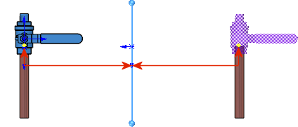

Center of
bounding box The
distance between the mirror plane and the center of the
bounding box is equal for the seed and the mirrored
instance.
![](zuy1557169202520.image) |

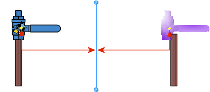

Center of
mass The distance between
the mirror plane and the center of mass is equal for the
seed and the mirrored instance.
![](gfb1557169340104.image) |

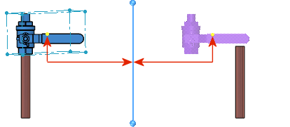

Component
origin The distance
between the mirror plane and the origin is equal for the
![](klm1557169427153.image) |
