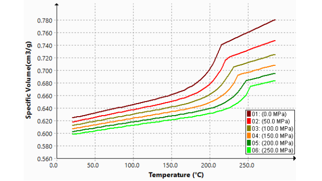

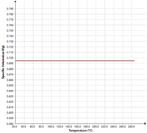

  • Updated 1167 grades from constant density to generic Pressure Volume Temperature (PVT) data to improve the accuracy of Fill, Pack, and Warp simulations

Material grade with constant Pressure Volume Temperature (PVT) data (2021)
Same material grade updated with generic PVT data (2022)
