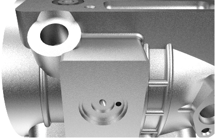

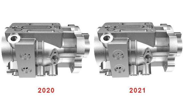

Corner Radius The Corner Radius functionality is enhanced to smooth edges in parts. Previously, the effect of Corner Radius was visible only if the appearance attached to the geometry did not use a bump or normal map. 2021: All hard edges are sharp because the appearance attached to the part uses a bump or normal map. 2022: The Corner Radius is visible even when the appearance on the part uses a bump or normal map. In the Palette, on the Models tab, on the Advanced subtab, specify Corner Radius (mm). Parent topicSOLIDWORKS Visualize Match Camera Perspective to Backplate Shadow Catcher Property Scenes Tab Animations Render Output Viewer Patterns Cosmetic Threads
