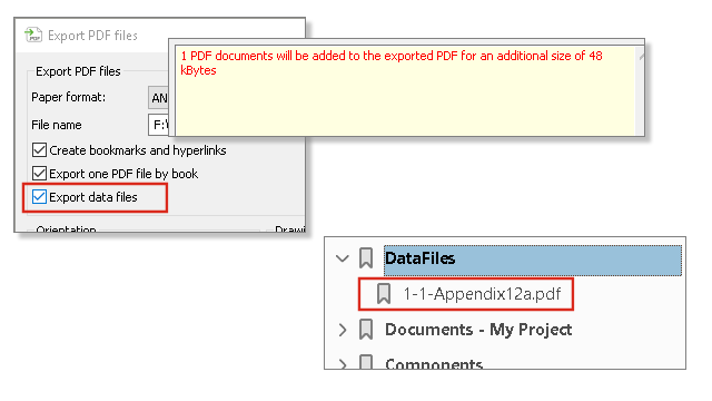

Add Data Files in the Export PDF If you attach PDF files to the project as data files, you can export them in the exported PDF file. When you select Export data files, a message displays the PDF file size. The PDF file gathers all the datafiles in a new section. Parent topicSOLIDWORKS Electrical Links in BOMs Testing the Query in the Expert Mode Displaying ERP Data in the Manufacturer Parts Manager Including Data Sheets in Exported PDFs Displaying Break Condition in Report Manager User Interface Redesign Attribute in Origin - Destination Arrows Displaying All the Wire Numbers on the Middle of the Line Electrical Content Portal Integration Connection Point Creation Enhancements
