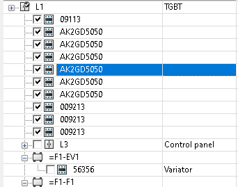

Insert the devices
The devices are inserted in a specific
drawing. The first step consists of opening the drawing attached to
the location for which you wish to create the layout.
The dockable panel displays the list of components at this location
and the location itself.
Each manufacturer part is preceded by a checkbox showing the elements
already inserted.
The menu displays a Cabinet Layout
section containing the specific layout commands.
You can also insert elements that do not appear in the list in the side
panel. Four icons are available.
