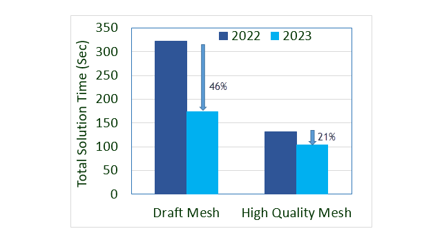

Solution performance is improved for frequency and buckling studies. The
image illustrates the solution performance for a typical frequency
study.
