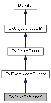

Inheritance diagram for IEwCableReferenceX:
