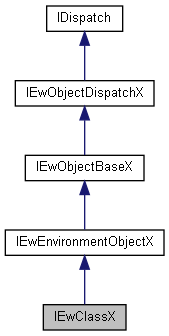

IEwClassX Interface Reference
Use this interface to manage an EwClassX object. More...
Inheritance diagram for IEwClassX:

- Public Member Functions inherited from IEwEnvironmentObjectX

- Public Member Functions inherited from IEwObjectBaseX
