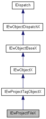

Inheritance diagram for IEwProjectFileX:

Detailed Description
Use this interface to manage file inside a project.
Since
2018 SP0
