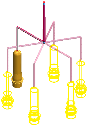

Show
Preview |
Displays a wireframe geometry of
the complete cavity or runner layout in the graphics area. Confirm that the complete layout is accurate
before proceeding with the simulation.
Preview of a complete cavity and runner layout that
exhibits cyclic symmetry about its central axis with a pattern of
six instances. |
