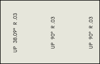

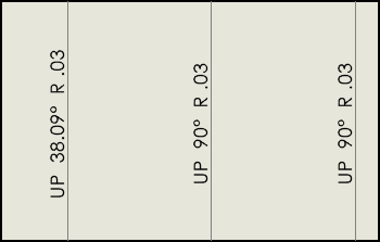

View Bend Lines Control the visibility of bend lines in flat pattern drawing views of sheet metal parts. Click one of the following: Hide/Show Items > View Bend Lines View Bend Lines (View toolbar) View > Hide/Show > Sketches View Bend Lines selected View Bend Lines cleared Parent topicManipulating Views
