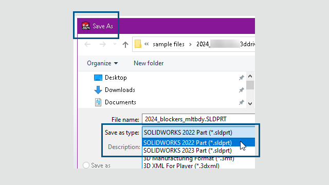

  1. Open or save a SOLIDWORKS document in the latest version of SOLIDWORKS.
  2. Click File > Save As.
  3. In the dialog box, for Save as type, select the previous version to which to save the document and click Save.
    If the document contains Incompatible Items or Other Items as described below, the Previous Release Check dialog box appears. Otherwise, the software saves the document as the previous version.

  4. Repeat the save process to save the file as the previous version.
