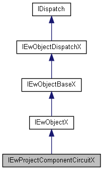

Inheritance diagram for IEwProjectComponentCircuitX:
Inheritance graph
