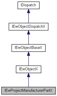

Inheritance diagram for IEwProjectManufacturerPartX:
Inheritance graph
