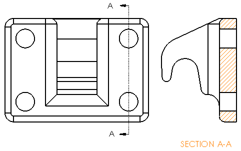

You can apply hatches to
specific layers. When you apply a hatch to a specific layer, the hatch inherits the
show/hide, print on/off, and color properties of the layer.
To apply a hatch to a specific layer:
- In the graphics area, select the hatch.
- In the Area Hatch/Fill PropertyManager, under
Layer, select the layer.
- Click
