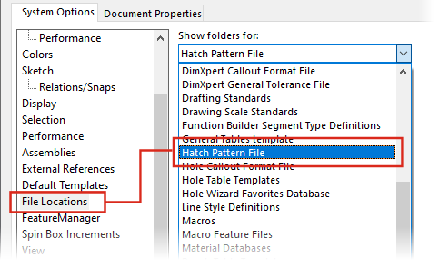

Click Options
(Standard toolbar) or
On the System Options
tab, click File Locations.
In Show folders for,
select Hatch Pattern File.
Select the current location of the hatch pattern file and
click Delete.
To specify the new location, click Add, browse to the new location, and click OK.
