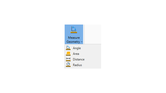

You can use the
MEASUREGEOM command to measure
an
area,
angle, distance, and radius.
In
previous
releases,
you had to run commands like AREA, DIST, and GETANGLE.
To access the Measure Geometry
command:,
Do one of the following:
- On the ribbon, click .
- Enter MEASUREGEOM in the
command window.
