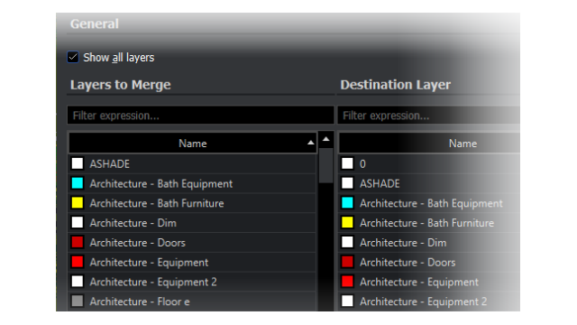

You can use the
MERGELAYER command to
reorganize
layers.
This command is
available from the Layer Manager palette that
helps
you
merge the content of selected layers into other
layers.
To access
the
Merge
Layer
command:
- On the ribbon, click .
- On the menu, click .
- Enter MERGELAYER in the
command window.
