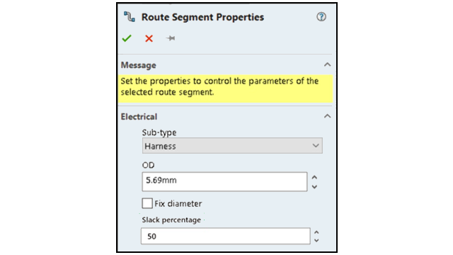

Customizing Slack Percentages in the Route Properties and Route Segment PropertyManagers In the Route Properties and the Route Segment Properties PropertyManagers, you can define a custom value for the Slack Percentage for individual route segments. This value overrides the slack percentage specified in Tools > Options > System Options > Routing. Parent topicRouting Faster Access and Easier Search in Electrical Attributes (2025 SP3) BOM Entry Shows Total Cable Length across Subassemblies (2025 SP3) Splice Highlighting for Improved Visualization (2025_SP3) Redesigned Routing Tooltips (2025 SP2) Support for Clip Assemblies and Clip Parts in the Routing Component Wizard (2025 SP2) Improving Performance in Flattened Harness Assembly Edits (2025 SP1) Create a Flattened Drawing with Cleaner Output Enhancing Pipe and Tube Modifications
