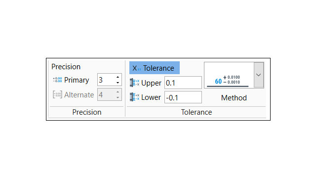

Adding Tolerance to the Dimension (2025 SP3)
You can add tolerance information directly to dimensions in drawings.
This ensures clarity by specifying permissible variations in dimensions, and supports accurate manufacturing and assembly processes. Adding tolerance has the following benefits:
  • Lets you define upper and lower limits for dimensions directly.
  • Provides various tolerance methods, such as symmetrical, deviation, and limit-based representations.
  • Lets you control the precision of tolerances independently.
  • Provides easy access to tolerance options through the Power Dimensioning Ribbon tab and Properties Palette.
