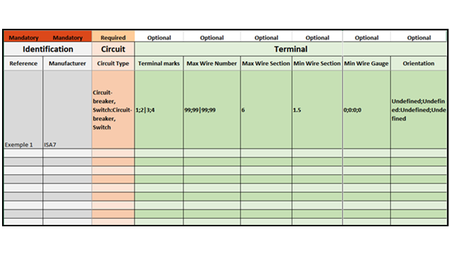

You can import data more efficiently by applying shared values to multiple circuits, terminals, or cable cores. While importing, if the values entered lack separators, the single value applies to all the circuits, terminals, or cable cores.
Benefits: This saves time and reduces manual input errors.
While importing the template in Manufacturer Part Management, if you enter a single value for a terminal column, it applies to all terminals of the circuit. For example, if for all the terminals, Max Wire Section is 6, you can enter only the value 6 without repeating the information. Previously, you had to enter the value 6;6|6;6. This is applicable when you select One line per reference for manufacturer parts and cable references and One line per circuit for manufacturer parts.
