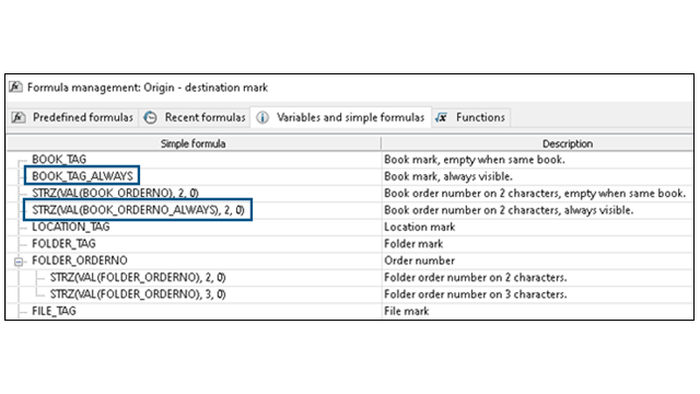

New Variables in Formula Management
New variables are available in the Formula Management dialog box that let you label origin and destination arrows more effectively. This makes it easier to find and understand bookmarks, especially when the arrows are in the same book.
In the Formula management: Origin - destination mark dialog box, on the Variables and simple formulas tab:
  • BOOK_TAG_ALWAYS variable appears under BOOK_TAG.
  • STRZ(VAL(BOOK_ORDERNO_ALWAYS), 2, 0) appears under STRZ(VAL(BOOK_ORDERNO), 2, 0).
In the Attribute management dialog box, #BUN_TAG_ALWAYS appears under #BUN_TAG.
