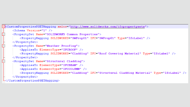

  3. Create an XML mapping file that maps the SOLIDWORKS custom properties to the IFC property set values.
    SOLIDWORKS offers sample mapping files at SOLIDWORKS install folder\lang\language\IFC.
    Sample mapping file:
    <CustomPropertiesPSETMapping>
        <Schema Version="1.0"/>
        <PropertySet Name="Pset_DoorCommon">
            <AppliesTo ElementType="IFCDOOR"/>
            <PropertyMapping SOLIDWORKS="Reference" IFC="Reference" Type="IfcIdentifier"/>
            <PropertyMapping SOLIDWORKS="FireRating" IFC="FireRating" Type="IfcLabel"/>
            <PropertyMapping SOLIDWORKS="NoiseRating" IFC="AcousticRating" Type="IfcLabel"/>
            <PropertyMapping SOLIDWORKS="Security" IFC="SecurityRating" Type="IfcLabel"/>
            <PropertyMapping SOLIDWORKS="External" IFC="IsExternal" Type="IfcBoolean"/>
            <PropertyMapping SOLIDWORKS="Infiltration" IFC="Infiltration" Type="IfcVolumetricFlowRateMeasure"/>
            <PropertyMapping SOLIDWORKS="ThermalTransmit" IFC="ThermalTransmittance" Type="IfcThermalTransmittanceMeasure"/>
            <PropertyMapping SOLIDWORKS="Glazing" IFC="GlazingAreaFraction" Type="IfcPositiveRatioMeasure"/>
            <PropertyMapping SOLIDWORKS="Accessible" IFC="HandicapAccessible" Type="IfcBoolean"/>
            <PropertyMapping SOLIDWORKS="FireDoor" IFC="FireExit" Type="IfcBoolean"/>
            <PropertyMapping SOLIDWORKS="StarTrekDoor" IFC="SelfClosing" Type="IfcBoolean"/>
            <PropertyMapping SOLIDWORKS="SmokeStop" IFC="SmokeStop" Type="IfcBoolean"/>
        </PropertySet>
        <PropertySet Name="ACME_CageCodes">
            <AppliesTo ElementType="IFCWINDOW"/>
            <PropertyMapping SOLIDWORKS="RefCode" IFC="CageCode" Type="IfcLabel"/>
        </PropertySet>
    </CustomPropertiesPSETMapping>
