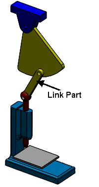

Fatigue Analysis of a Link Part
The Link part of the Punch assembly is analyzed using fatigue analysis. The loads for the reference static study are imported from SOLIDWORKS Motion as illustrated by the Importing Loads from SOLIDWORKS Motion lesson.
