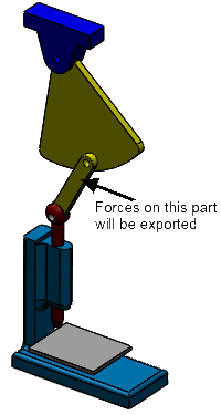

After you run a motion study, you can export to Simulation the forces developed on individual parts to calculate their stresses and displacements. You can export motion loads for one or multiple time frames. Simulation creates a design scenario for each selected time frame populated with motion loads developed at the particular time frame.
