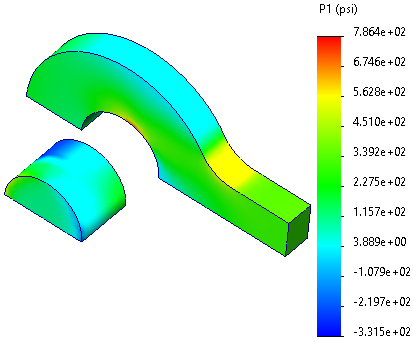

Viewing Principal Stresses In the Simulation study tree, open the Results folder. Double-click Stress1 (-vonMises-) to display the plot. If the plot does not exist, create this plot. Right-click the plot icon and select Edit Definition. In the PropertyManager, under Display: Set Component to P1: 1st Principal Stress. Select psi in Units . Click . The first principal stress plot is displayed. Parent topicContact Analysis of an Eyebar Assembly Previous topic Meshing the Model and Running the Study Next topic Plotting Contact Pressure
