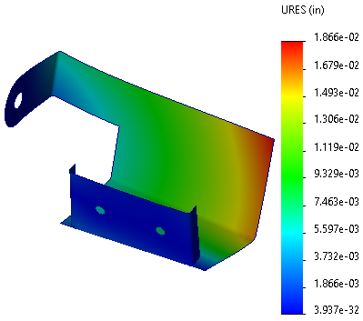

Viewing Resultant Displacements Displacements for top and bottom faces are assumed equal. In the Simulation study tree, open the Results folder. Double-click Displacement1 (-Res disp-) to display the plot. If the plot does not exist, create this plot using steps 3, 4, or 5 in Viewing Stress Results on Top Faces Rotate the model as shown in the figure. The plot is shown in inches above. You can right-click the plot and select Edit Definition to change the units. Click File > Save to This PC to save the model, then close the document. Congratulations! You have completed this lesson. Parent topicStatic Analysis of a Sheet Metal Part Previous topic Viewing Stress Results on Bottom Faces
