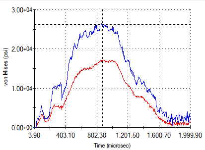

  1. In the Simulation study tree, right-click the Results folder and select Define Time History Plot.
  2. In the PropertyManager under Response, select Vertex 1 and Vertex 2.
  3. Under Y axis, do the following:
    1. Select Stress.
    2. Select VON: von Mises Stress in Component .
    3. Select psi in Units .
  4. Click PM_OK.gif.
