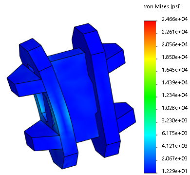

  1. Right-click the Results folder and select Define Stress Plot .
  2. In the PropertyManager, under Display, select psi for Units .
  3. Under Deformed shape select User defined and type 1 for Scale Factor .
  4. Click PM_OK.gif.
