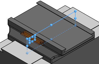

Adding a Third Mate
Add a third mate between the bracket and saddle to fully define the bracket location.
  1. Click Isometric .
  2. Add a Coincident mate between the Right Plane of bracket and the Right Plane of saddle.
