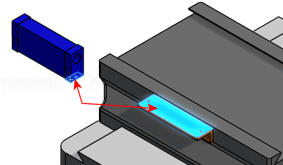

Positioning the Encoder Head Add mates to position the encoder head on the bracket. Add a Coincident mate between one of the small bottom faces of the head and the top face of the bracket. Parent topicAssembly Mates Previous topic Adding a Third Mate Next topic Adding a Concentric Mate
