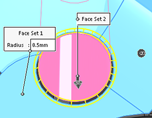

Import Diagnostics reports that four gaps remain because there are two missing fillets for each screw hole.
  1. Click to close the PropertyManager.
  2. Click Fillet (Features tab).
  3. Under Fillet Type, select Face Fillet.
  4. Under Items To Fillet:
    1. Select the top faces surrounding the screw hole for Face Set 1.
    2. Select the inside face of the hole for Face Set 2.
  5. Under Fillet Parameters, set Radius to 0.5mm.
  6. Click .
  7. Repeat steps 2-6 to fillet the other screw hole.
