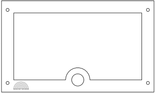

Now reposition the inserted sketch entities.
  1. In the FeatureManager design tree, right-click Sketch1 and select Make Edit Sketch.
  2. Repeat step 1 and select Edit Sketch .
  3. Add the dimensions from the lower left corner of the rainbow to the gasket edges, as shown, to position the sketch entities.
    If the sketch does not appear to move, click Rebuild .
    You can click Smart Dimension (Dimensions/Relations toolbar) to define the dimensions between the sketch point and the lines.
  4. Click Exit Sketch .
