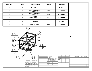

Completing the View Click in the sheet to open the PropertyManager for a new drawing view. Under Scale, select Use custom scale and select 1:20. Place the relative view as shown and click . The face you selected for Front is facing frontward, and the face you selected for Bottom is facing downward. Dimension the relative view as shown. Click File > Save to This PC and in the dialog box, click Save All. Congratulations! You have completed this tutorial. Parent topicWeldments Previous topic Creating a View of a Weldment Body
