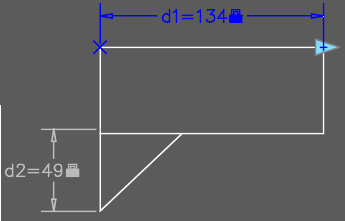

Example:
d1 is a dimensional constraint parameter
d2 is a dimensional constraint
