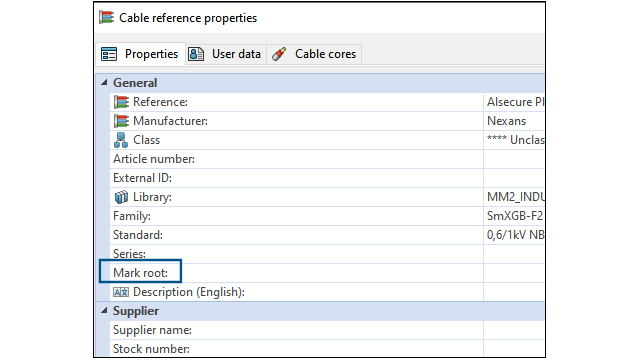

- In the Cable reference properties
dialog box,
you can
specify the Mark root
option in the
Properties
tab. When you add a cable to a project from the cable reference,
it
automatically copies the Mark root from
the cable reference to the cable's mark root. This value is also accessible for
filters.
