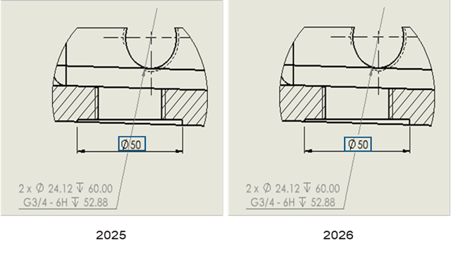

Adding Breaks to Dimension Lines around Dimension Text
You can add breaks to dimension lines to avoid overlapping dimension text.
To add breaks to dimension lines around dimension text:
  1. Right-click a dimension line that overlaps dimension text and click Add Dimension Break.
  2. Optional: After you add a dimension break, you can right-click and select:
    • Remove Dimension Breaks. Removes an existing dimension break.
    • Update Dimension Break. Modifies an existing dimension break.
