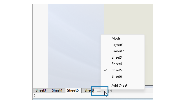

  • At the bottom of a drawing sheet or tab, click List to view a list of sheets or tabs that are open. At the bottom of the list, Add Sheet or options to create a new study are available.
