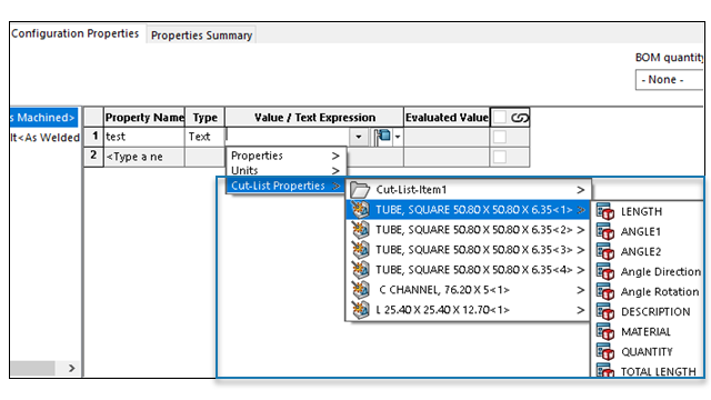

You can
access cut list properties from the
Configuration Properties tab of the
Properties
dialog
box.
To access
cut list properties from file properties:
- Click File Properties
(Standard toolbar).
- In the dialog box, on the Configuration Properties
tab, select
the configuration
name.
- For Property Name, enter
the name of the property.
- For Value/Text
Expression, select Cut-List
Properties.
- From the Cut-List
Properties flyout menu, select a cut list body and its specific
cut list property.
Value/Text
Expression displays the formula: $PRPWLD:"*Cutlist Item name*:*Cutlist Property Name*".
SOLIDWORKS® links the selected cut list property to
the formula.
