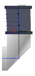

To use the Sketch Tools, open the ribbon cable assembly and right-click in the graphics area. You can add or delete segments, and add or delete dimensions.
ribbon_cable_sample

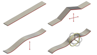

Also, handles are added to the route path so that you can control the twist and bend on the ribbon cables.
wn2013_ribbon_cables_2
