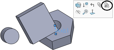

You can open the View Mates window for any selected reference geometry, such as planes, axes, or other reference geometry.
To view mates for selected reference geometry:
  1. Open an assembly.
  2. Select mated reference geometry, for example, a mated plane or axis.
  3. Click View Mates menu_View_Mates.gif.
    The View Mates window lists mates that reference the selected reference geometry.
