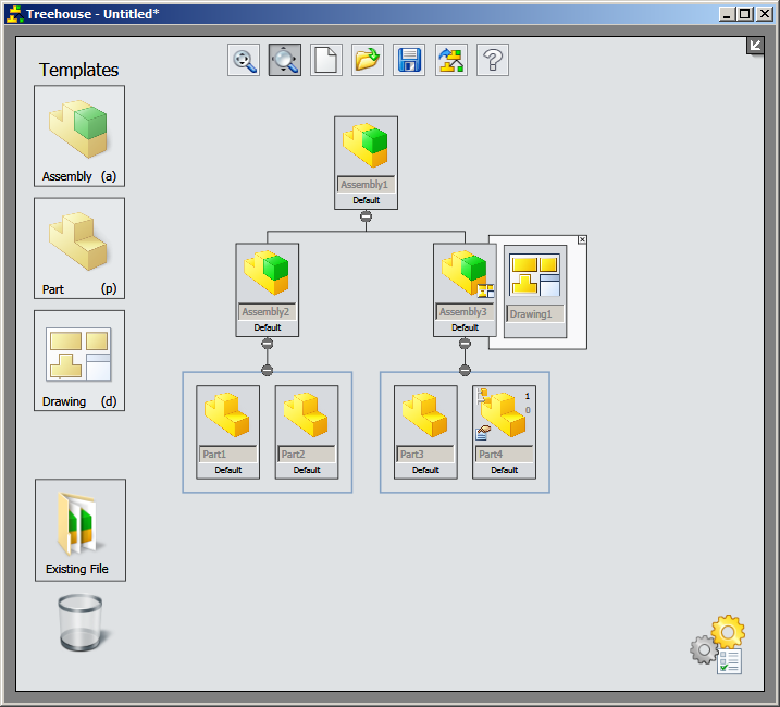

With Treehouse, you can set up your SOLIDWORKS assembly hierarchy in a graphical user interface before you start building your models in SOLIDWORKS. You can also use Treehouse to add to an existing file structure.
To run Treehouse, in Windows, click Start > SOLIDWORKS 2015 > SOLIDWORKS Tools > SOLIDWORKS Treehouse 2015.
In Treehouse you can:
  • Drag part, assembly, and drawing nodes into the graphics area to create a file structure.
  • Edit file properties.
  • Add configurations.
  • Suppress components and component instances.
  • Drag existing documents into Treehouse from Windows Explorer.
